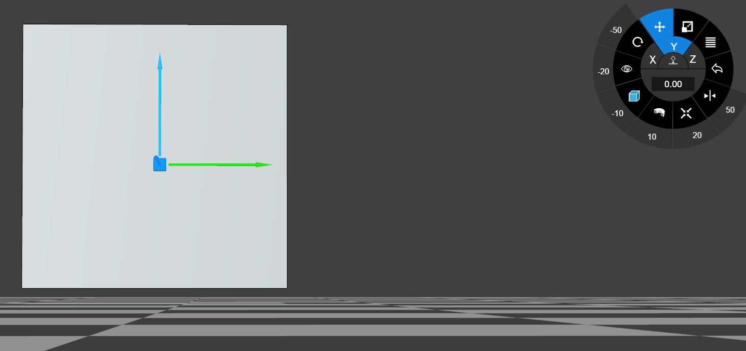

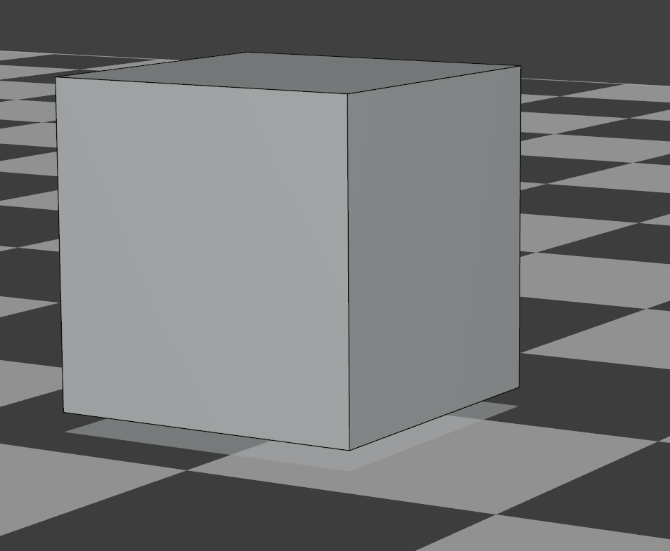

@jimmy44033
Here is a cube that has been rotated and auto-placed by the software which still leaves a gap.
Another view.

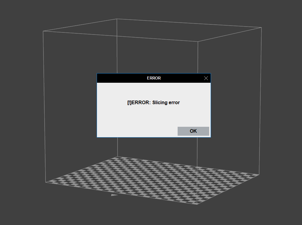

I have turned off all supports in the supports editor and always get this error when slicing
@Jason-TT
Is there a fix for this?

Has it always had problems like this, or is this with just the latest update (v2.6.34)?
This is strange. Is the cube generated by UP Studio, or is it an imported STL file?
I am currently running V2.6.43.627.
I updated this morning to the version above.
It is an imported STL file that was converted in Solidworks.
will also get support along edge if your part has a slight radius or chamfer along the edge, was told thats just the way it is.
