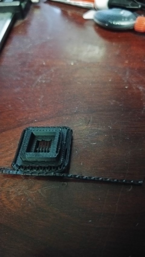

I think maybe he is talking about this…?
I noticed it on test printing of the simple XYZ cube, one face isn’t fully bonded to the body. the infill doesn’t even touch it and I can get my fingernail in the gap!
Yes, This is exactly the problem - The entire face is not bonded to the infill, on all models, on most settings. It makes it impossible to create prints with integrity as one face is always detached internally and is easily damaged and breaks away.

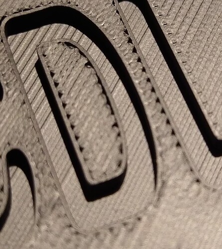

You can actually see in the slicing where the gaps are too large. Pics below show the printed part and the slicing of the same part. You can see where the infill does not reach the edge line on both the left inside of the “D” and the left of the “L”. This is a slicing issue that should be easy to fix but has been around for ages.
