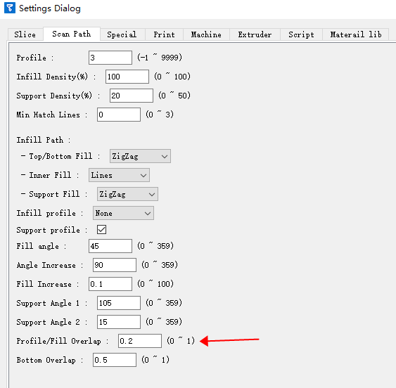

用于使用刺激物来修复填充和周长之间的差距。调整重叠百分比。

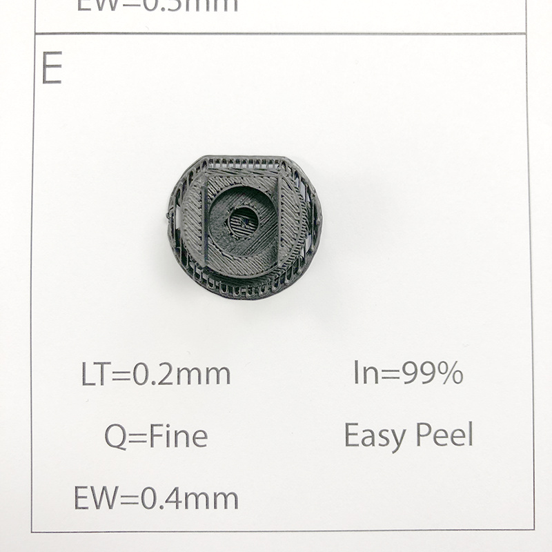

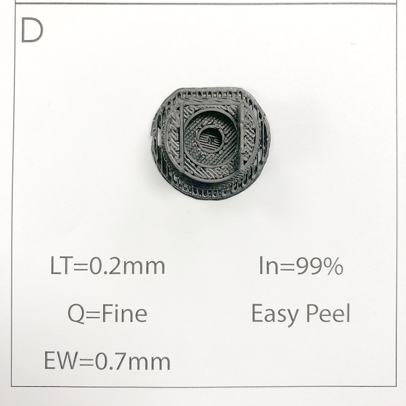

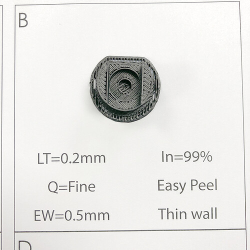

I did some tests with variations on my most commonly used settings using Studio 2.6.31.627 on an UPBox (despite the compatibility warning) using UP Fila Black ABS.
Tried to mimic the part used in@jothamb.帖子(有点)
图像
Lowering the extrusion width seemed to help a little in my case, but it’s not “perfect” and the gap could be a little tighter.
We only the increased the overlap rate in TPU profile for 2.6.31. In the next version we will increase the overlap rate in other materials and open up this option in the material profile of UP Studio, so user could adjust base on their needs. please be aware that too much overlap may cause over dumping and could cause unknown adverse effects.
2喜欢
因此,对于使用工作室的人来说,可能会根据TPU基础TiVertime材料创建个人资料,并从那里修改其他材料。
My question is, is it really that difficult to put out a version of UP Studio that has an increased overlap value for all custom materials made in Studio?
只是一个简单的更新,可以推出并让我们和其他用户快乐的打印部分,没有恼人的空白。
