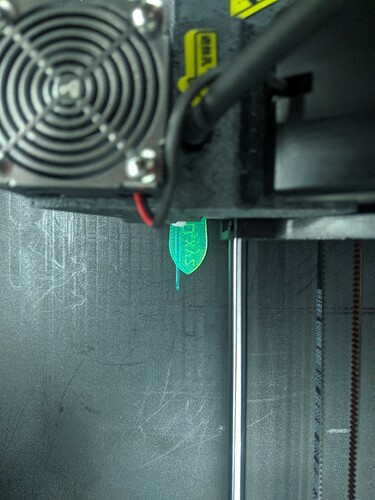

好了,我终于把我的床一样水平的人ually and now I can get it to print without having to use a raft. I decided to print a 3D benchy to see how things look. When it started printing, the strip to prime the nozzle was laid down kind of right through the outline of the model I’m printing. Is this normal?

I have no idea why the prime line does that at the start of the print inside the raft. Does this happen with all prints or just this one once? This is definitely not normal.
I assume you used UP Studio for this and not Catfish? At the moment it is possible for Catfish to do weird things with the raft if you play with the settings.
It’s possible that your head is crashing or stalling at the start of the print. Listen closely to see if you can hear the motors stalling when the print starts, and when you initialise the printer.
That’s the only thing I can think of that will be causing the problem. -stepper motors deregistering their position.
In my picture, that is not a raft. I was printing PLA without a raft and it was putting that prime line inside of my part. It does it consistently, and this was in Up Studio. One of the things that I have found so frustrating with this printer is how it treats the first layer differently when printing without a raft than it does the first layer when printing with a raft. I’m about to remedy all of the issues that I’ve had with this thing since day 1, though, as outlined in my other post. Thanks for the reply, though, Jimmy!
