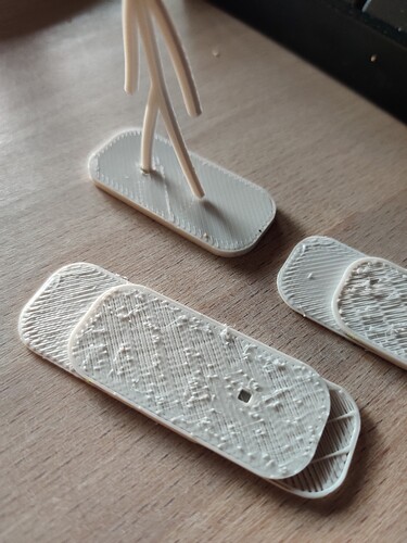

I use rafts for 90% of my prints, it’s when I print without one because they are small I get layers shifts, sounds like it doesn’t lift the nozzle enough when moving over models when I print multiple, works fine when I print one.
I have zero problems with first layer, it’s halfway in to the print I have issues:frowning:
That pictacular print ran out of pla at the end…
If your rafts are scratching, you may try update the compenation values of the 9 leveling points. for scratching region, reduce the value of compensation.
For the figuring shown in picture, if print multiple item with no support, the nozzle could knock down the print. In UP studio 3, we will add a new option z hop in next version, to reduce the knocking effect.
Your photo looks like overextrusion. If the first layer is overextruded the nozzle may stick on the overheight while moving above the part. then your motor may skip steps which causes layer shifts.

Yeah i fixed that by heating the bed and using 3 layers of paper for leveling.
It is the nozzle that’s hitting the other models, so i just print one at the time.
