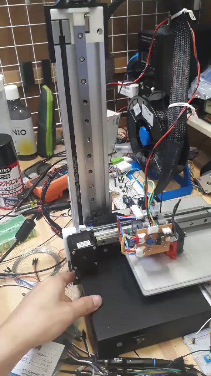

First function:
Press and hold the front switch when before initialize, initialize to cetus.
This is same function from UpStudio.
Second function:
Double click the front switch when after initialize, Cetus do previous printing.
Third function:
Press and hold the front switch when after initialize, X and Y axis move to near limit switch.
下Z轴小,power off(no current to motor).
But this is not usually done.
Because when Z axis little up, cetus throw out “Motion System Error Z-”.
The way of try third function, you operate z axis limit switch in manually when initialize Ceuts,
I think throw out the error to be an anomarly in the third function,
I prepared two movie.
error occurs and doing power off.
Please check in other Cetus.
And I want to make sure only my problem.
Cetus3d mk3 default front switch
I upload my printer default front switch behavior video.

It is same behavior my machine.
I have one question.
Does upStudio give you an error after you press and hold for a second time?
wooden, I checked again and it shown “Motion system error Z”.
