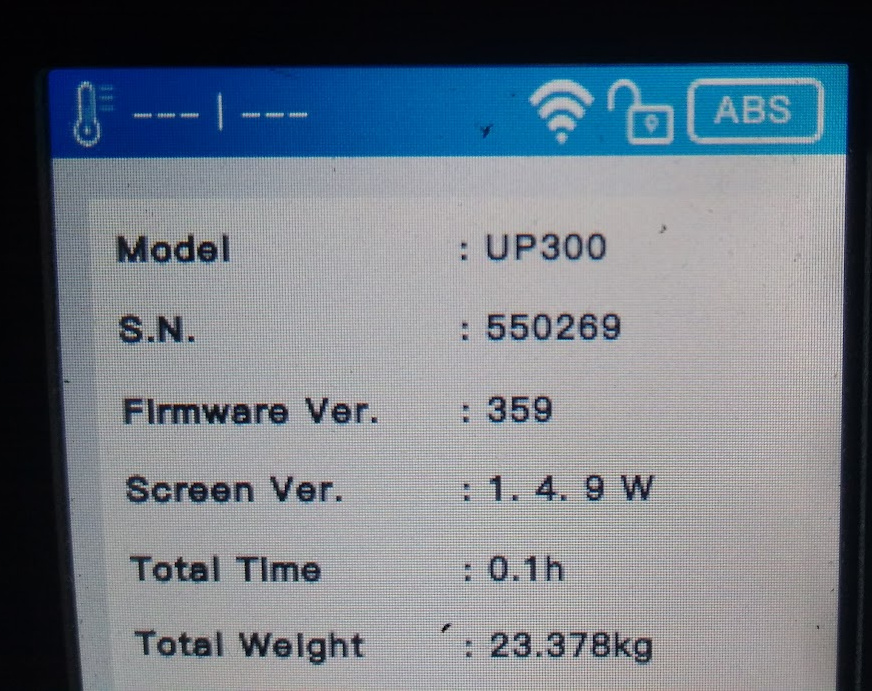

    • The hour counter on my UP300 has stopped working
      Reply: Would you provide a photo showing the current hour counter value? we will check what happened
      Here is the hour counter: The last firmware upgrade also reset the Total Weight counter to 0 kg, but has since started counting, but the hours has remained 0.1h

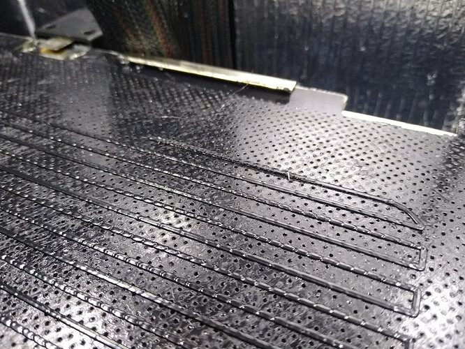

Today the printer filament jammed again. Here is what I found:
齿轮已经将丝状磨碎。仔细看看:
请放大图像并仔细看看。
它看起来像它放在同一条线上。在我开始此打印之前,这款印刷盘100%刮擦干净。我报废了全部它清洁,然后施加一些ABS /丙酮溶均匀以增加对板的粘附性。我100%肯定,这不是一块从最后一张印刷品留下的灯丝。挤出机堵塞,因为齿轮磨削灯丝。图片显示了6小时的完成印刷。所以现在我有另一个失败的打印。2天前我发了同样的问题。杰森你之前见过这个,你有解决方案吗?

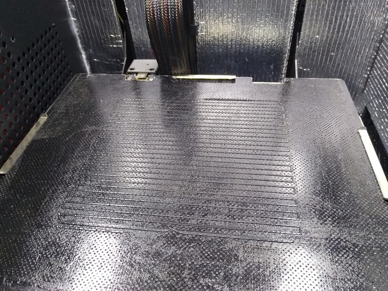

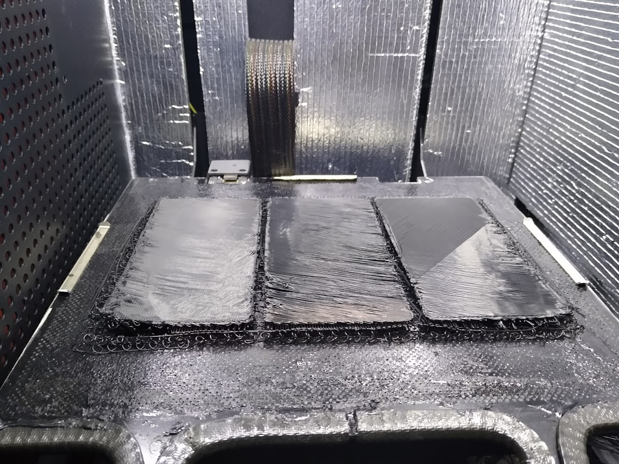

我刚刚得到了家,我的印刷看起来像这样:
我已经重新测量了校准高度。它曾经设定为229.75mm。但现在它出现了230.75mm是喷嘴几乎触摸床的正确价值(我的感觉用喷嘴和床之间的纸张来找到正确的高度)。奇怪的。我调整了校准高度才能正确。
I’ve checked that there is no rubbish in the way of the Z axis limit switch.
我再次开始打印:
同样的事情。所以我取消了打印并立即进入校准菜单,然后将其移动到230.75,并能够验证设定高度是否正确。
我已经怨恨它是一个新文件。关闭打印机,然后再打开。我重新验证了校准高度值是正确的。所以我打印了我发送的新文件。我得到了相同的结果。它太高了。我以前从未有过这个问题。
What now? I need to print parts, I’ve got deadlines to get this stuff done.:懂:
床变成了unlevel。解决了。这是1.5岁的水平 - 从来没有出现问题,直到今天。

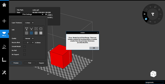

新的触摸屏今天到达。我刚刚完成安装它(随着ESD预防措施被拍摄,Wriststrap正在处理我触摸的内容......),并且我已经将其更新到最新的固件(截至写作时间1.5.10)。
到目前为止似乎都很顺利。
对于其他人来说,也许通过稍后或通过Googling找到这个:
如果你得到:
Error: Model Out of Print Range: There are models outside the forming space or models smaller than the print layer thickness. (4.4.402.402.401)
Then remember to set the nozzle calibration height under the calibration menu on the touchscreen. New touch screen had a default value of 0.00mm, so of course, anything I try print is outside the possible print area. I probably would have known to do this if I went through the official documentation step by step I’m guessing.
这已经解决了这一点。谢谢@tama.@Jason-TT对于备件 - 非常感谢!
