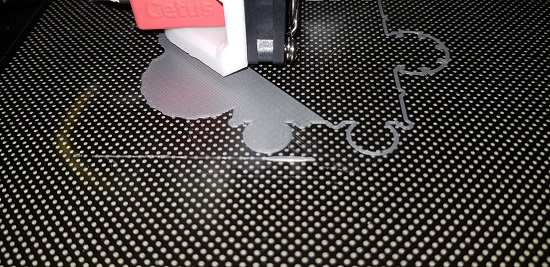

In the Print Settings set the nozzle offset to the chosen layer height, as you had in mind. Here’s a photo of my Mk3 printing on the heated bed with stock perforated board + 0.2mm PEI sheet.
