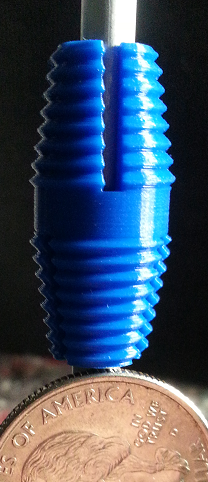

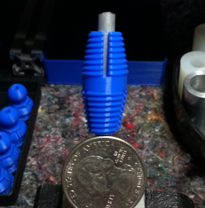

So, after the aggressive build-plate leveling procedure mentioned above, I wanted to see how accurate this modded MKII could print at .05mmLHeight x .25LWidth using the stock .20Noz.
启动了S3D并加载了SyntaxGeek的.20Noz S3D配置文件(Thingiverse-3035906),这是@antoledcetusamazing S3D profile also available from Thingiverse. Huge shout-out to@antoledcetusfor his S3D .40Noz profile, I used his profile to print the models shown above in an earlier post.
Loaded Thingiverse-2039065 (this is the coupler and nut as shown in an earlier-post above printed .40Noz .20LHeight .40LWidth 65mm/sec). Attempted .05mmLHeight x .25LWidth using the stock .20Noz. No-go, too many settings to dial-in .05LHeight on the .20Noz, It’s the extruder flow-rate that needs tweaking, just don’t have the time to investigate.
这是一个以40毫米/秒的速度打印的0.20Noz,高0.10l,宽0.25l的耦合器。
no supports, no raft, no brim…just those 3 tiny pillars you see at the top of the coin.
Coupler02Noz10LHeight25LWidth40mmsec
edit: I know, crappy photo, I just can’t get past the pain right now, sry folks.
edit: below, better photo showing profile of coupler:
25L宽40mmSecropd%20%5B2%5D
cheers,
布伦特
Technology Salad

看起来是个很漂亮的指纹!
1喜欢
Tks for the feedback@比约恩, difficult to show the profile while keeping overall focus but also trying to display the layer lines. A shallow depth-of-field while in macro mode because of the taper, need a 3D camera to properly photograph this type of subject:wink:
这是以40毫米/秒的速度打印的.20Noz,高.10l,宽.25l的耦合器。
  • no supports, no raft, no brim…just those 3 tiny pillars you see at the top of the coin.
cheers,
布伦特
Technology Salad
