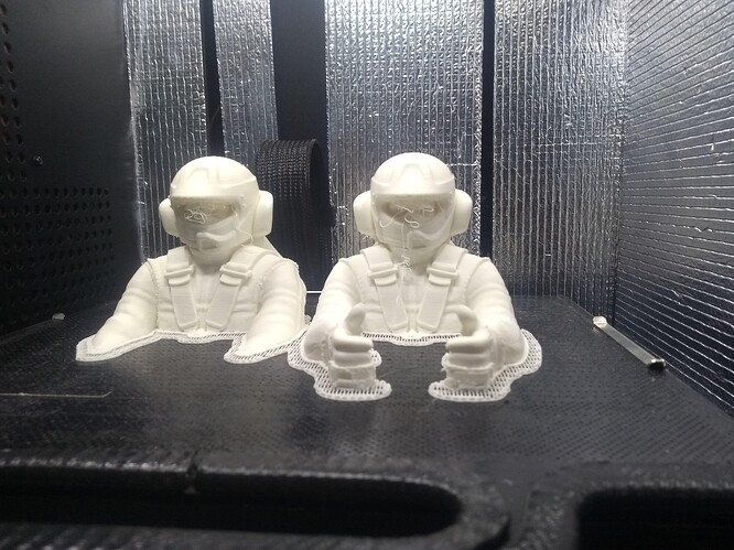

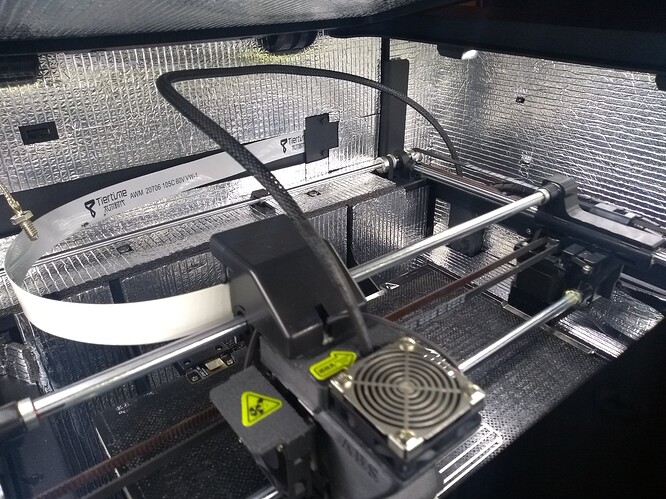

I got 5mm insulation foam. It comes covered in aluminium foil on one side, sticky tape on the other. See pictures:

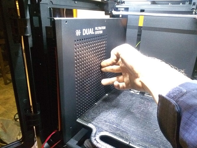

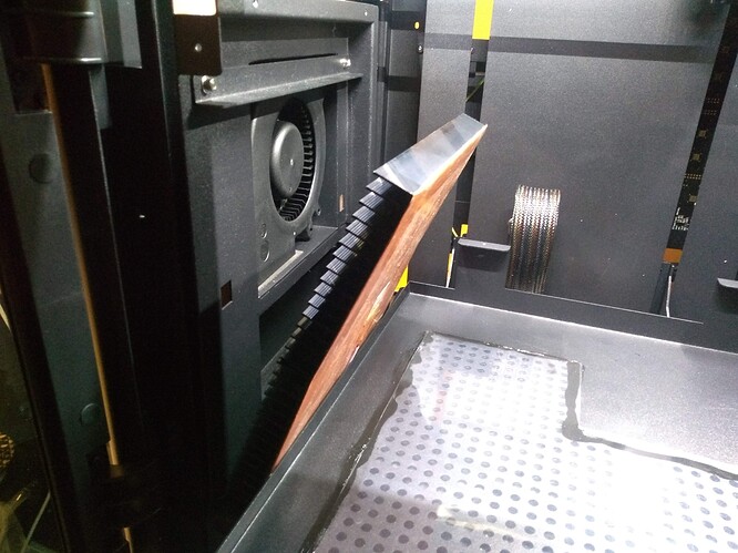

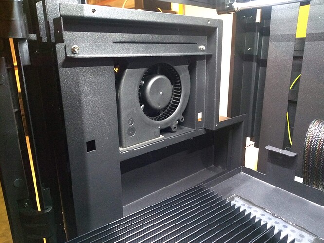

Also some pictures of how I replaced the air filter with a 200w pid controlled heater to keep the internal temperature steady. It also has a thermal fuse placed inline just in case something goes wrong.
Actually I did take off the panel on the left to get that one done.
Thanks for the pictures, that helps a lot! I really like the added heater idea but I really don’t want to remove the filters to add one even though that’s a really clean installation.

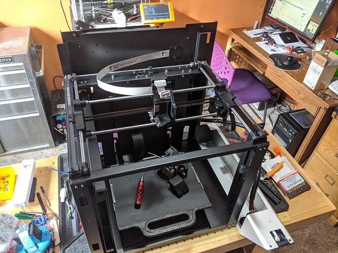

So I went ahead and did a thing yesterday…
我甲肝病毒e insulation on the way. Oh, and also a Duet 2 WiFi. I’m not going back to the 80’s and use a command line driven piece of software to run what was supposed to be a workhorse type printer.
看起来太棒了!你把整件事下来吗?我甲肝病毒en’t worked out how to do it quiet that far yet.

It’s not that bad to tear down, actually. My first goal is to get it running with the Duet 2 and printing ABS reliably. The extruders have been reliable for me, so far. I am going to add a more accurate Z probe so I can do mesh bed leveling. I think that with the changes I’m making, this should be a really good printer. The mechanics of this machine are really nice.
