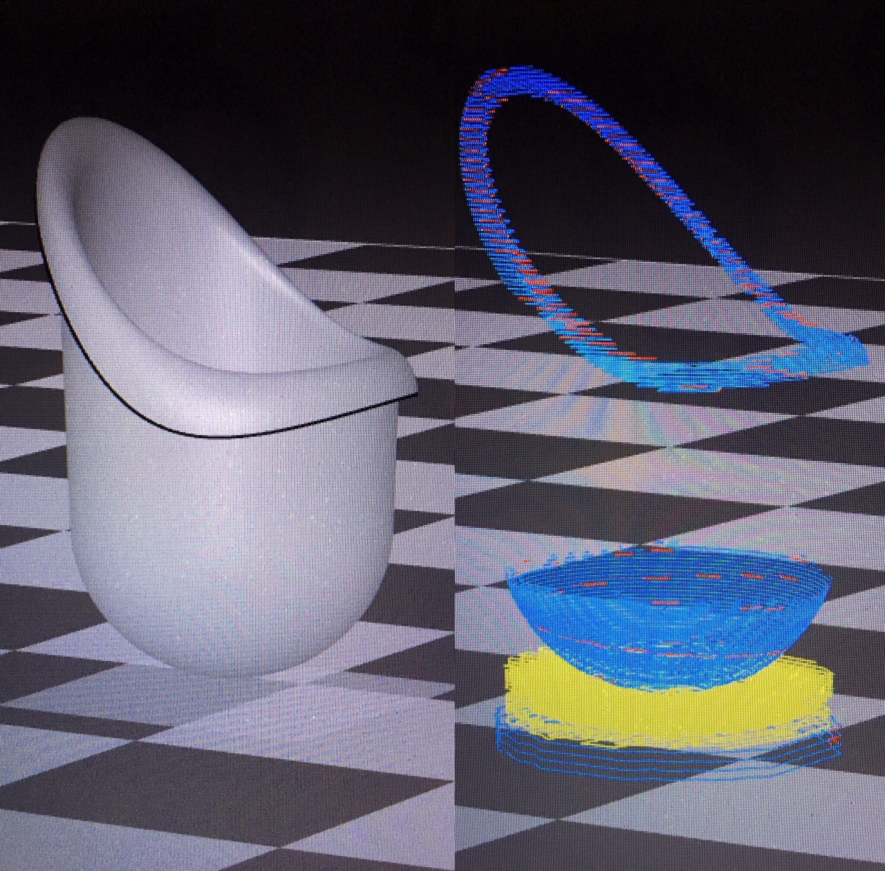

In this article we will share a typical case when printing thin wall model,
One of our customer ask why the model show incompeleted in print perview, Please see the photo below;

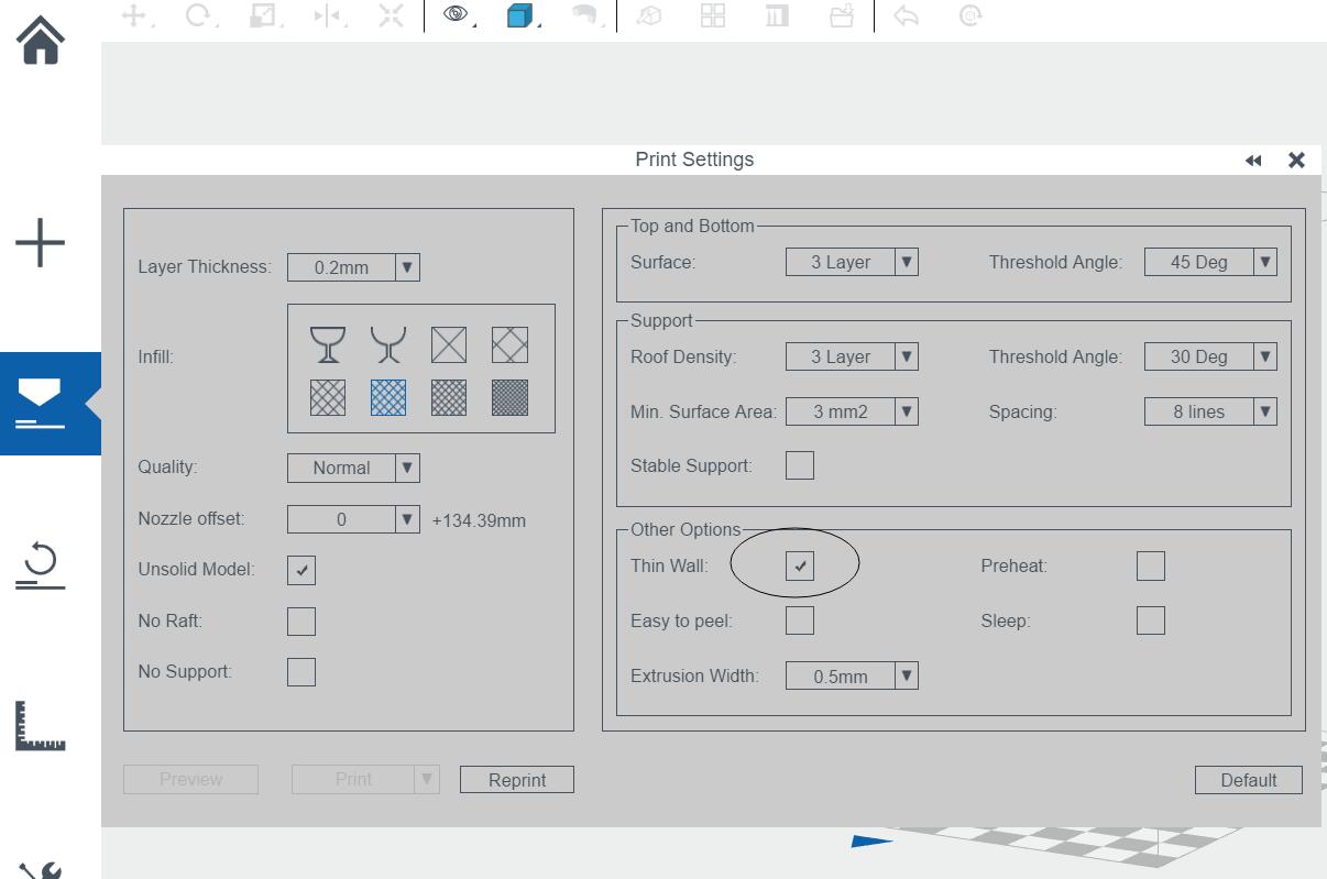

The reason for that is the outer wall of the model is too thin and thinner than the minimum width of the extruded filament, Then it will caused the failed printing, To solve this issue, Please select ''Thin Wall'' mode in advanced ,then the missing features will be printed.

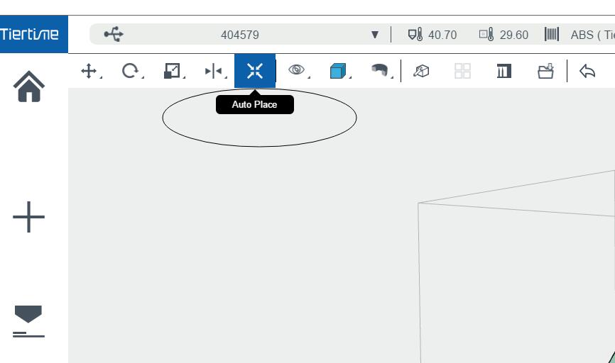

By the way, The model also need to auto placed ,because the model was placed "Hanging", By auto placing the model can avoid the unnecessary support in first few layers.
