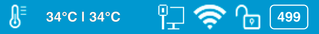

The touchscreen is consistent with two sections: Status Bar and main menus.
From Left to right in Status Bar:
Nozzle Temperature, Build Plate Temperature, LAN Status, Wi-Fi Status, Private Settings, and Remeaingling Materials
