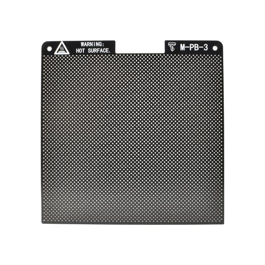

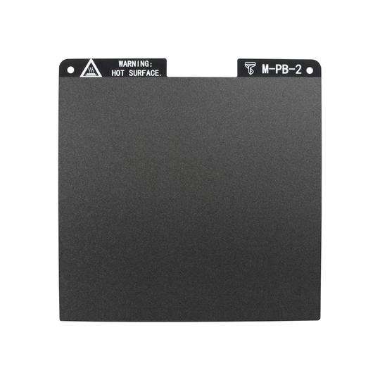

UP mini 2 ES offers two types of build plate, UP Flex (Left) and UP Perf (Right). Each of them provides unique print surface characteristics.
TYPE | UP Perf |
UP Flex |
FEATURES |
Maximum first layer adhesion; Flexible surface with holes, Difficult to remove raft. |
广告媒介第一层hesion; Flexible without holes, Same surface as Flex Sheet. |
PREFERRED MATERIAL |
PLA = ABS+ = ABS | PLA > ABS+ > ABS |
PRINT SETTING |
Print setting with raft. |
Print setting with or without raft. |
