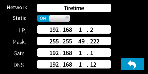

To edit printer's Static IP Address on LCD screen, go toConfigure-> clickNetwork,and chooseEthernet.
SwitchStaticon in order to edit I.P, Mask., and Gate.

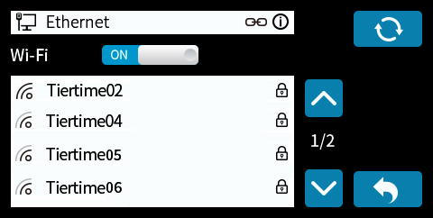

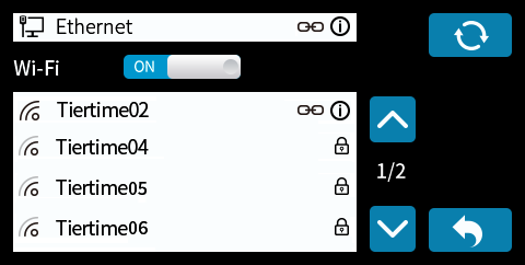

You can setup the printer's Wi-Fi from its LCD screen and software. Make sure your printer and PC are connecting to the same network, otherwise, software cannot find the printer.
To set up Wi-Fi, go toConfig-> ClickNetwork-> Switch onWi-Fi, selectNetwork Nameto connect, then input password.
